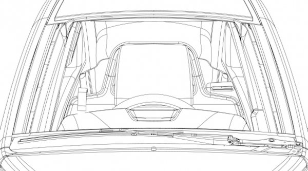

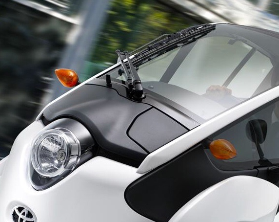

Possibly similar to the Elio's windshield wiper design for a narrow windshield.
My understanding is that it will be very similar to this but most of the mechanism will be hidden from view and the entire wiper will be hidden out of the airstream when stowed.

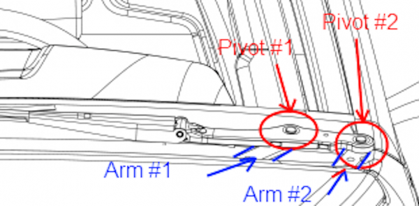

Elio Motors has shown a drawing of the P4 with this type of wiper on it however we have not yet seen it on an Elio Vehicle.
*Top image was provided by member RogWild and the lower one can be found on blog.eliomotors.com. I did crop and/or blow up the images to make things easier to see.
We will quickly adapt however it will look odd for a bit as the wipers will move horizontally across the windshield instead of in an arc like in most vehicles. The good news is that we will save some money as we only need one wiper blade. :D
