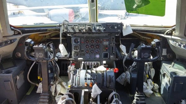

With just a glance, which means more to YOU:
or:
The oilfield instrumentation company I worked with had produced a terrific panel of extremely accurate LCD digits, but in an emergency, numbers speeding by on the screen were not helpful. They had to put a status bar alongside each digital display simply to inform the operator whether the numbers were increasing or decreasing because a spinning four-to eight digit display was meaningless. In a disaster scenario, it was a matter of life and death - not just whether you were going to void your warranty. They ended up with a panel that had at least two readouts for every function, one digital and one simulated analog, plus color-coding that would flash yellow or red to draw attention to the most critical changes taking place. All of this was to replace a simple set of needles and numbers. It just didn't work well with humans.
There is a good reason that wristwatches that once went to digital displays came back to three hands. Sure, if you were asked the time you could say "It's 11:45:42." with great authority - but you had to think about it for an instant to determine it was just under 15 minutes 'til lunch. That's the problem with digital readouts - humans are relational in their thinking - we need to see numbers in a context that is meaningful. If the temperature gauge is in the green, that's good. If it says "240°" we have to think about pressure and bring in a couple of Gas Law equations to understand something's about to let go. Sometimes an analog display is "close enough". It's how we interpret things quickly.
Digital displays don't even work for watches - even less well for mission-critical instruments.
