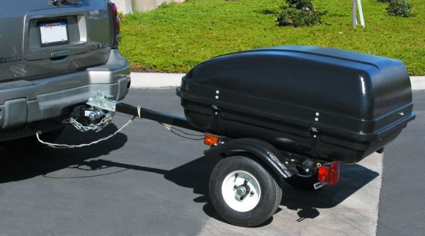

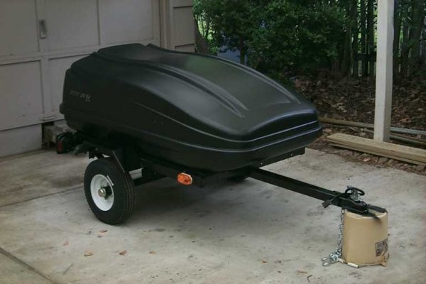

If you look around you can easily find narrow and relatively light utility trailers which would be perfect for Elio towing. My plan is to build or buy something like this:
View attachment 5043 View attachment 5044
Both of these trailers are relatively light and inexpensive as they both came from harbor freight. The first one is built on a harbor freight chassis and uses a standard roof carrier bolted to it and the second one is a complete harbor freight unit.
Base trailer without storage unit - http://www.harborfreight.com/870-lb...ailer-with-8-inch-wheels-and-tires-42708.html
Complete Trailer - http://www.harborfreight.com/600-lb-capacity-78-inch-tag-along-trailer-66771.html
There are a few inexpensive upgrades which should be done to these inexpensive trailers to make them ride better and lost longer. It helps greatly to upgrade the wheel bearings and pack them in good quality grease as this will make them last a long time without giving you much trouble along the way. Isolating the leaf springs using some thick rubber pads will make the trailer handle much nicer. Also upgrading the wheels and tires plus purchasing a spare at the same time will make everything ride nicer and save you hassles down the road.
I have that very Harbor Freight trailer that I have pulled behind my Harley Electra Glide Classic. It pulls very well. I added a small Harley luggage rack to the back of it. The luggage rack has LED tail and brake lights built in. Hey, maybe I'll put one on the Elio, yeah I know, it would cost some mpgs...
RUC, What is the differance between hauling a 250# Big A++'ed person, in the back seat and towing a 250# trailer, besides having Better company/less verbal feed-back, and shorter gas stops??lol If you don't tow, you don't know.
True I never towed, but having 250lbs in the backseat in-between the wheels seems like it would be safer than pulling along 250 behind, have no idea of the physics, but i do know as per other posts when you were to put 250 on the rear seat of a rice burner(rear seat up in the air) that too would have a detrimental effect (raise center of gravity), perhaps one of our fellow members ( engineers) could describe it better than I-- hey I know whatever I post won't change minds, but just wanted to put it out there, I wish us all the luck in driving our Elios, which will require as much diligence as bike riding- especially gawkers for the first year at least. Enjoy!!
I have that very trailer that I have pulled behind my Harley Electra Glide Classic. It pulls very well. I added a small Harley luggage rack to the back of it. The luggage rack has LED tail and brake lights built in. Hey, maybe I'll put one on the Elio, yeah I know, it would cost some mpgs...
Glad to hear the trailer has worked out well for you as it looks like a number of us will end up with this type of trailer for our Elios!
I am sure it will affect the MPG some however being narrow I am betting it won't be too terrible as it should draft the main car body pretty well. Either way an Elio with a trailer will allow for hauling two people and a good amount of gear while still beating just about every other car in mileage.
