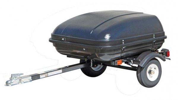

I love the single wheel motorcycle trailers and other extra lightweight alternatives however those are way too much money for my expected trailer use. My plan is to instead buy or build something similar to this for the extra cargo capacity I need for weekend camping expeditions and extended trips when traveling with two people on board.
This one is available from harbor freight for about $370 and weighs about 145 lbs empty.
http://www.harborfreight.com/600-lb-capacity-78-inch-tag-along-trailer-66771.html
I know that between the extra weight and added aerodynamic drag pulling this type of trailer would hurt my fuel efficiency however I seriously doubt I would lose more than 25%. Even if my highway number was lowered to 'only' 60 MPG it would still be worth it as that is much better than anything else available while carrying the same load.

Wow. So two wheels in the front 60 some inches apart. One wheel in the back, centered on the car. And now two more wheels, maybe three feet apart on the trailer. Can you imagine trying to dodge something in the road with all of that? Like playing twister!
Trying to dodge anything while towing a trailer is always a tricky proposition!
My crew-cab pickup or full size van pulling a 15' or 20' trailer do not react well to sudden movements either. This is one major reason why I recommend keeping the loaded trailer weight down to a reasonable level of 250-300 lbs maximum.

Well at least in your truck/van and trailer combo, you still have the center to straddle whatever is in the road. This set-up is like a wall of wheels!

My plan is similar, only using a cargo box like this:
http://www.walmart.com/ip/Sportrack-Auto-Rooftop-Cargo-Boxes-Your-Choice/22218859
At 76" long by 23.8" wide by 14" high and adding 16 cubic feet of storage. I plan to fab a single wheel trailer to mount it on. I think I can make it for under $500 in materials. With the narrow width and a "short tongue" It could be "tucked in" real close in the "slip stream." Estimated trailer weight of 100lbs and cargo weight of 200lbs, the tongue weight could be under 150lbs (loaded properly) with the heavy stuff to the rear.
That is the Idea. But as Jebar said,..."until we get folks out there towing and report back the results we won't know how they perform." :)
