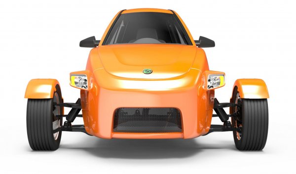

Isn't the E1C a partial coilover setup? I think it looks cool already.
Maybe a little paint and chrome, and it's up there with any looky lou hot rod.
Maybe a little paint and chrome, and it's up there with any looky lou hot rod.View attachment 21578
Partial?? What's the difference between a partial and a full Coil over???
Nothing that I can think of; it's either coil over or it's not.
I mean, you can do different grade of coils, but if it's coil over, it's coil over.
I guess you could do a separate coil + a coil over shock, but you really don't gain all that much except a mess.
Or a coil over shock, and a leaf spring if the vehicle was big enough, but I don't see that happening on an Elio, or maybe torsion bar.
But there really isn't room for all of that gear.

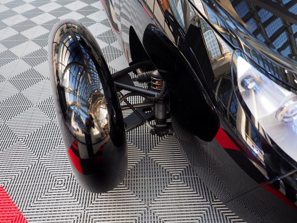

For us non-gear heads....Other than looks, what's the big deal with diagonal coil-overs?
For me, I like coilovers that provide ride height adjustment as well as adjustments to spring preload, compression, and/or rebound dampening. You can get shock/spring setups that provide dampening adjustment, but usually not ride height too. Coilovers are usually more tuned to sporty driving instead of cushier comfort rides. Since I live and commute in an area with good road conditions and few potholes or speedbumps, I can run a lower ride height than stock and increase the compression and rebound for a sportier ride without being jarred to death. And if the ride if too harsh, dialing back the dampening only takes a few minutes to turn four little knobs. Makes it nice to be able to switch between commuting mode and hill country carving quickly.
