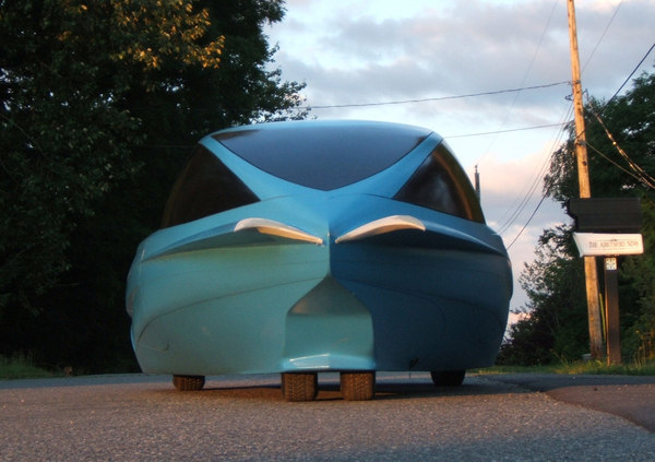

This could be a path Elio could go after the E-car gets off an running . Seem like a possible offering Elio Motors would look at to me , and in ways resembles the E- car somewhat . I do notice four tires on it though. This could be a family Elio and with a three cylinder turbo version ,it could get the same mpg and performance ,if not better.
I like the steering linkage protection vs. the Elio's outriggers. It looks like vaporware in general, though. Don't forget the Aptera.

Zoleco. From the photo gallery, it does seem to be a three wheel car.
From this view, the back wheels are close together like the Isetta. Diseno-Art.
Would the vehicle shown (what ever it is) be considered and 3 wheeled motorcycle or a 4 wheeled auto? The two wheels are close together but they are 4 separate wheels. You would have to buy 4 tires not 3.
