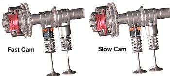

There is much confusion over the IAV valve train. According to the spec sheet seen along side the demo engine on tour the head uses "switchable tappets" components only used with VVT. Techtalk v4 says "2 stage VVT will be used". Techtalk v24 says" VVT will not be used"(do to expense considerations) but the animation clearly shows 2 cam lobes per intake valve follower. I think at this point in time everything is just speculation. I also think the reason we have a forum is to get a variety of opinions and points of view. After all if we all thought just alike how would we learn anything.

In the very first Tech Talk IAV/Elio did not state that this engine will have variable valve timing but instead what they wrote is that the engine will use 'two-step variable LIFT technology'. This information is further corroborated by the IAV/Elio demo engine spec sheet stating that 'switchable tappets' will be used as switchable tappets are specifically used to change lift. Switchable tappets are commonly used as one component of a VVT package however there is nothing to say they can not be used on their own. In the following rendering you can see how dual cam lobes can be used in combination with switchable tappets to provide two stage valve lift.
I will admit that I was also confused about the VVT until I went back and re-read the two Tech Talks and discovered that Elio Motors had all along claimed variable lift and not variable timing.

IAV/Elio has not released much direct information on the valvetrain so there are some valid question which we simply to do not have good answers for at this time however the engine animation video and what little we do have in writing does help give us some good clues as to what is possibly going on.
Being able to pep up the engine that way sounds great to me! You could even do it via a switch on the dash -- economy vs. power mode. ECU moves from Program A to Program B (and back again if wanted).Great valve train rendering Goofy. My contention is if you have 2 stage lift you also have 2 stage duration. Anyway since this is likely electrohydraulically controlled by the ECU it may be adjustable thru the smartphone app. (Pure speculation on my part) I'm still impressed with phones that have buttons rather than a dial.
