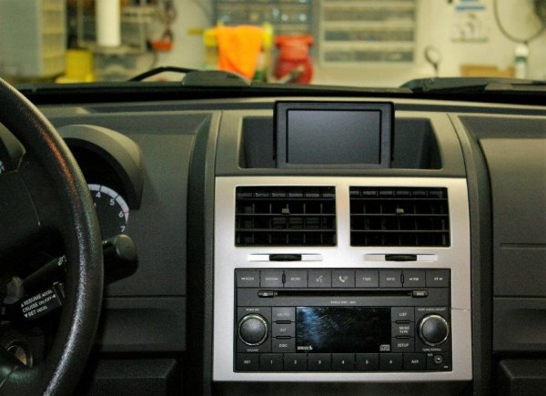

When I put the Backup camera in the Nitro I thought the same; then I read in the reviews problems with vibrations in the monitors that clip over the existing mirrors and mirror focus problems with the ones that replace your mirror (aka not the best quality) so I went with a dash mounted monitor.
At first I thought 7" and it measured really tight in the area I wanted to put it in, so I went with the 4.3" and it's give a great picture for $20 (it also has multiple inputs)
I thought the same with line of vision, and as big and tall as the dash is, it worked out great.

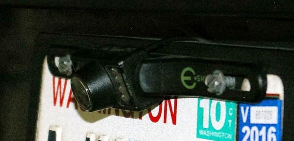

The camera I started with what I thought would be a good angle. Yeah, if you want to watch birds backing up.
So I did the move, look, move, look, move, bingo, wrong, move, try again.
The back of the Nitro is tall enough I had to go almost full down to see low level items.
I put a stool behind me and measured distance for the line scale it shows on the monitor.
The closest red line was 2.5' of distance which is plenty tight enough in a parking space.
Anyone that plans on doing their own camera system should do the same steps.
Know how far it is from the lines in the monitor to a solid object; don't "guess" what it should be because they are all different.

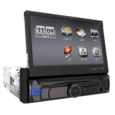

Seems like a single-DIN head unit with flip out monitor and rear camera input would be a good way to go. That's what I'm planning to do.
Power Acoustik PDR-780B 1-DIN Digital Media Receiver w/ 7" LCD Touch Screen at Onlinecarstereo.com
