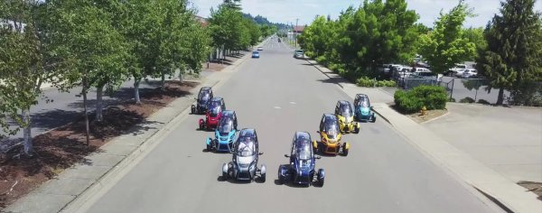

I say Go FUV! Most fun I’ve had driving/riding a no tilt/low CoG three wheeler EV.
