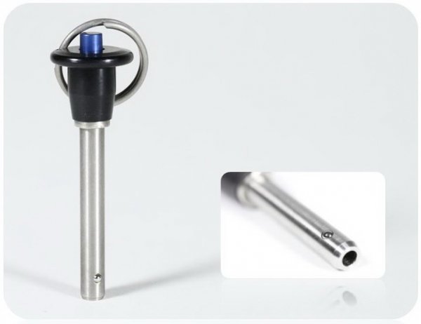

Here's something I've been wondering about lately... The fairings/fenders are held on by two pipes that slip over other pipes (basically) and are held in place by 2 set screws on each pipe (total of 4 set screws per fender). How likely are those 4 set screws to remain tightly in position if you keep changing them out? How many Elios will be running around with one fender because the other side launched itself into the stratosphere when the set screws came loose. Sure, we should check them before every ride but, like on my motorcycle, I may look to make sure the tires are inflated, but I rarely (never) pull on the fenders to make sure they haven't come loose.

Ditch the set screws, drill all the way through both pipes, and install four of these babies (might look familiar to the avaition crowd for "remove before flight" flags). If you know the OD of the female pipe, just order a set with the "grip length" that's closest. Easy to release too when it time to change a flat, or swap out the fenders/fairings.
[quick release push-button pins]

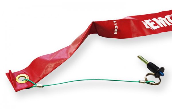

That's the beauty. You take the little ring out, and swage a short piece of cable from the pin handle to the frame (like the picture, but minus the key ring). It'll make them harder to steal, but nothing's theft proof is someone wants it bad enough.

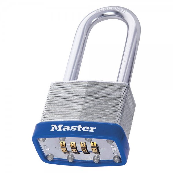

Hey, you could easily use one of these or something even more appropriate...
Now that I look at it.... China? I thought Masterlocks were made in the USA! Sigh...
