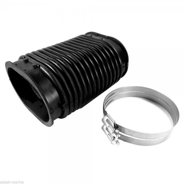

I like it! St. Louis sucks too. I feel your pain! No sure what size this is, but I'd bet there'd be something that would fit the bill in the marine industry. It's either an exhaust bellows, or a stern drive bellows shown...I need to look into this further.

I like it! St. Louis sucks too. I feel your pain! No sure what size this is, but I'd bet there'd be something that would fit the bill in the marine industry. It's either an exhaust bellows, or a stern drive bellows shown...I need to look into this further.View attachment 2600
Something like this would need to be at least 1½' in diameter. Also needs to be detachable for easy access.

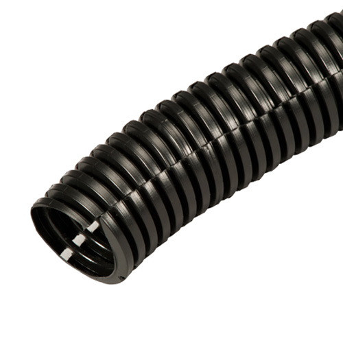

Something like a split loom for wiring harnesses maybe. Just need to know what size would fit the A-arms. Might keep some of the salt and crap off the suspension. Take if off when the weather gets nicer.

Pablotech1--- to enclose the entire front suspension you'll probably need a bellows over a foot in diameter. If you're intension is corrosion prevention you're better off painting the suspension components with heavy bituminous paint (the kind of paint used to coat battery boxes) and rinse the suspension with water after know exposure to road salt.
