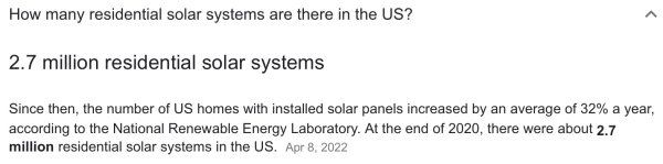

What's the percentage of EV owners who charge their EVs through solar?
One needs to fact check the sources and the ready to rumble politics regarding “disaster“ Statements.
Residential solar systems currently in the US and will likey increase dramatically with public interest and transition to EVs.
US has a population of 335M. Even if everyone was in a family of 4, that is 83.75M. So let's round that up to 84M. So you are saying that 0.03% of the population is going to make a difference in the energy consumption with solar panels? Most people are not able to store excess energy, even if they are able to produce enough to power their homes.
