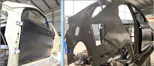

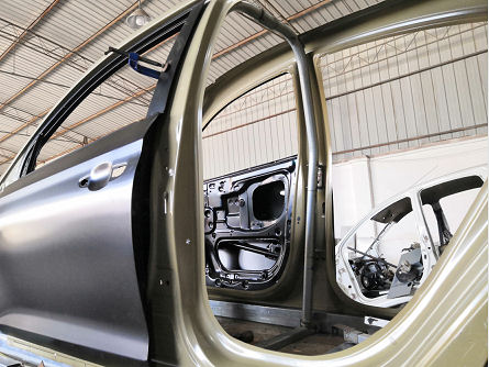

Not very good pictures today sorry, the glare in the factory today was blinding, but that's all I got.
Front doors are bolted to the frame, and it only took a G-clamp each side to align the side panels around the doors, but the weight of the rear half of the panels is still too much, so now I have to put the rear doors on as well.
This is a hassle.
I need the main roll hoop to mount the rear doors to, but I need to set it all up with the doors in place to understand the exact width of the bodyshell at that point, which includes then knowing the roof skin dimensions, but I need the roof skin on to strengthen it all up and into position so I know the width for the roll hoop, that i mount the rear doors off, but there is no roll cage to mount the doors which need to be mounted to figure the roll hoop ..... confused yet?
Hope so, because I am, and it's a catch 22 situation ....
I'll probably make up some temporary jigs to line it all up and maybe temporarily screw the doors into place.

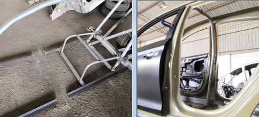

Some feeling when I started cutting up the frame of the prototypes today, hard not to when you have put so much time into something, then execute it ....
The reason was to retrieve the main roll hoop, stick it in the new car to get dimensions from the new one I will make the next few days.
It may look like it fits the new car, but it doesn't, close but not usable.
