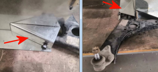

Everything is shut up tight this year, more so than normal, I guess due to covid. It's like Xmas day or New Years day when everybody is shut, I expect this will last until next Monday, the 30th.
Lucky I can still fabricate by hand, annoyingly slow as it is, today designed and made the lower control arm front mounts, more complicated than they look.
