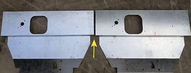

Ack, I made a mistake, such small mistake but made the firewall unusable.
The issue is my CAD drawing parts have zero thickness and I simply calculate in my brain where the thickness will make the difference, easy enough, but I made the mistake of calculating the 2mm/0.080" thickness on the wrong side of the bend, which made a 4mm/0.160" difference, the difference can be seen at the arrow.
So lasered and bent a new firewall this morning, but have to be a little careful with the shops I use, they are also dying from the heat, and it wasn't 100% happy faces when I roll up and they have to walk away from their giant fans (laser shop) or their air conditioned office (fold shop) ... don't want to burn my bridges, these people are critical to me at the moment. They did appreciate the ice creams I bought them though

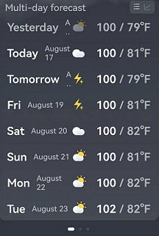

Further good news is though it's still 100 degrees, you can feel the humidity starting to drop the last few days, as it should be in the middle of August.
