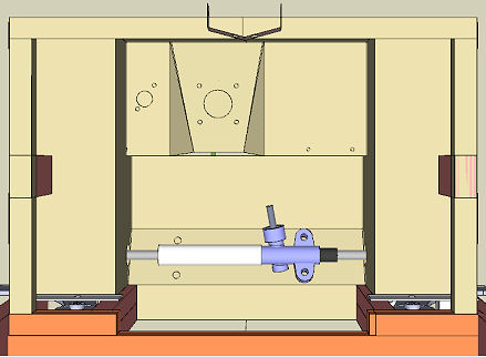

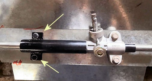

Ok, back into it today.
I added simple mounting tabs to the steering rack, arrows, and the keen eye'd who look hard at racks, will notice that all the complicated mounting nonsense from the prototype has gone, and this setup simply bolts directly to the firewall, hope it works out with the steering geometry.

...and this setup simply bolts directly to the firewall.
Mark... I don't claim to know very much about steering racks, but I do remember a "Luxury" car maker having difficulties with bolting a steering rack to the firewall. At some point the steering rack (on these luxury cars) started tearing the firewall. I do think someone came up with a reinforcement kit, not sure who??
It may not be a factor with the BEX Mongrel, as your vehicle will be much lighter than a full size car and the forces and stresses should be substantially less.
Just for your own knowledge bank Sam, aprox 20% of all cars are bolted to the firewall, the rest are usually bolted to the engine crossmember. In fact this actual rack is a firewall mounted unit. Crossmember is merely preferred because it can be fitted on the production line as a single assembly (the complete front end).
It's all in the engineering, knowing where the load paths are, and where they going :-)
