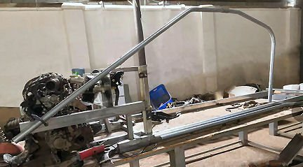

I bent up a set of roll cage today, very easy as I now how the patterns to work from, and they are bent on a flat plane. The people at Boeing weren't impressed.
The only change is clear, the forward cage tube goes all the way to the main engine rail.
Just standing in place by the grace of one loose clamp, later to fall and scissor my finger when I went to remove it ... I am in pain and suffering, but on the other hand, I'm just fine.

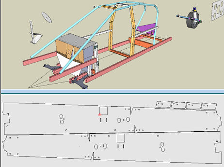

The last few days have been the Dragon Boat Festival for yet another National holiday, and the laser shop closed, but I am ready to go first thing in the morning with my B pillar file to be cut and folded, and the A/B pillar jig is sitting in place just waiting.
As you can see in the CAD drawing, the pillars are critical to positioning the roll bars, so tomorrow cometh please ...

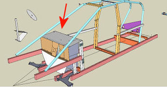

I know some are techinically interested in the build, and the changes, so one thing I can mention I am pleased with, is I have lowered the dash bulkhead by 2", which will improve forward visibility of course. Red arrow ..
Dash lowered by two inches sounds like a good bit! Everything counts toward the total sum of driving enjoyment!!:thumb:

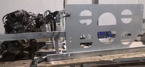

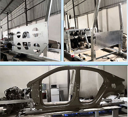

B pillars (center pillars) were finally lasered and folded today, letting me weld them into place with the aid of my longitudinal and lateral jigs holding them in place.
This allowed me to sit the side panels on so i can line up the roll cage tomorrow, and everything gets so much easier after that.
