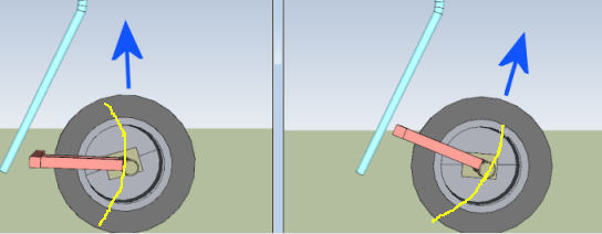

Sorry Mark, I was thinking ahead, after the vehicle is built. Is it possible for the rear end to become too light?
Of course, that's why effort has gone into keeping the weight at the front as low as possible, so less lever weight transfer under braking and heavy cornering.
I have built in anti-dive into the front suspension as well to help limit weight transfer lifting the rear.
I'm thinking of when you hit a pot hole with just the back wheel.
I did discuss it earlier, the rear suspension is design to move rearwards as it goes up and over a bump, to lessen the impact. I have done this because it's going to be almost impossible to not hit things in the middle of the road sometimes, so the impact needed to be softened for both comfort and tire damage limitation.
This also creates anti-lift helping to keep the rear of the vehicle down as the braking rear wheel force pulls the swingarm pivot down.
