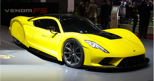

Every so often the creative rebel in me just has to be heard, or seen in this case...
I just love hacking 4's into 3's.

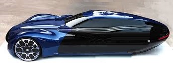

As you can tell I'm a bit obsessed with how tandem three wheelers can look very 'hot' and still be a very efficient vehicle. In part because this is still a fairly untapped opportunity. There are a number of interesting prototypes in 3 wheels, but compared to what exists in 4 wheels, just a pittance. Just staying inside an exploration of cloning existing super-cars can take up a person's full career. So I just spend enough effort to give a taste of the resulting form. A lot of this is enabled by the EV drive train, since it can fit in spaces a modern ICE drive can not.
Also conveniently, a 2F1R layout with integrated fenders has huge spaces behind the front wheels for low-laying battery pacts. I try and keep realistic for space allocation and such things of actual seat position, door entry and viable line-of-sight. Door entry remains one of the most challenging aspects. A lifting door is often the resolution to that problem.
Because of the angle of view, the one above could represent a narrow sociable seating or a wider tandem cockpit, but this one below probably is just sociable seating, I'd have to do another cut to what it's look is like in tandem. But the one below had traditional doors, and the one above has to have lifting wing-doors or a clam-shell hatch.
I hope the Elio gets built and this catalog becomes a useful resource to inspire the Elio II.
Have you considered sliding doors rather than lifting? It seems with the 2F1R layout that rearward opening sliding doors would be easy enough to implement.
