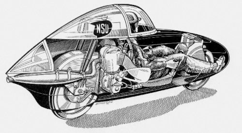

NSU pursued the "Flying Deck Chair" project. In May 1956, HP Müller drove an economy test over 65 laps or 500 kilometers (310 miles) at the Hockenheimring at an average speed of 100 km/h (62mph) and consumed only 5.65 liters (1.49 gal) of fuel thanks to the extremely low air resistance. That was 1.13 liters for 100 kilometers (208mpg). This Baumm III had the 125 cc four-stroke engine of the NSU Superfox , was more comfortably equipped and slightly shorter than the Baumm II and Baumm IV, which were designed for maximum speed.

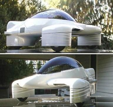

Even something cool like this; (from earlier in this thread: I raised the roof on this image from the origional: California Commuter Car II)
Thier complaint is that it would be like sitting in a coffin. Obviously, some people will not go for low and tight, even if it looks cool.
So on anything that looks catagorically like your coffin idea, I guarentee 5 people will love it and even pay top dollar for it.
But that might be about it, depending on the final look, or what attributes hooked them on it.

The CCII above could reasonably get 400mpg (in competition) with a modified and wheazey 90cc motorcycle engine. Doug Malewicki (or someone like him) made a covered motorcycle for competition and achieved 400mpg with 1980 technology (250cc), so it's do-able. The NSU flying Deck Car from 1955 below, even older engine tech, is much more aerodynamic than Doug's motorcycle with a full fairing was.

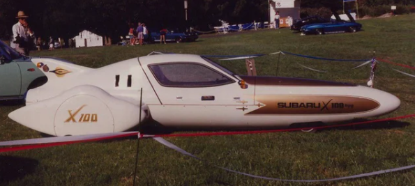

Years later, the x100 Subaru, 100mpg or better, not as much like a coffin, but tight.
How many people would buy anything like the vehicles in this posting? Well, at least 5, I guarentee it.
