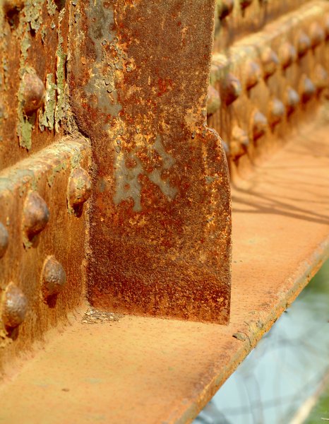

It's all about the coatings. Rust (corrosion) is the most expensive infrastructure-related problem the US (and the rest of the world) has to cope with. Bridges, highways (rebar rusts), refrigerators,autos (in Cleveland, a car typically loses 10 pounds of its weight every year due to rust / corrosion), pipelines, skyscrapers, and the cheapshit metal grills rusting on every patio all rust. From the sockets of your light bulbs to the AA cells in your toys -- it costs us literally billions of dollars a year. Bridges collapse in Minneapolis and elsewhere. It's endemic. The picture shows a railroad trestle that is at least 80 years old and is still in daily use.
With correct coatings, rust and corrosion can be slowed way, way down. But as a society, we would rather rebuild our bridges every 30 years then spend the money to galvanize them, then paint them ... and more than double their lifespans.
This is dumb. In Ohio, we've finally seen the light and over 50,000 replacement bridges have been both galvanized and painted ... and the down-the-road savings will be tremendous.
There's a wonderful book on this topic called, simply, Rust: The Longest War: Jonathan Waldman: 9781451691597 ...
It's an amazingly lively read and makes the subject absolutely non-boring.
Now as for Elio, exactly how careful they're going to be with their stamped chassis and metal body to make sure, for instance, that they're not using incompatible metals in either chassis or panels AND THAT THE FASTENERS DON'T MAKE IT WORSE --- well I don't know. Few people give rust a high enough priority.
Of course, at the price point, Elio is basically a disposable car -- economically speaking, 5 or 6 years and you can just throw it out. Disposing of cars creates many problems, too -- but face it, it's not designed to run for 100 years and a day. So maybe I'm fretting for nothing.
