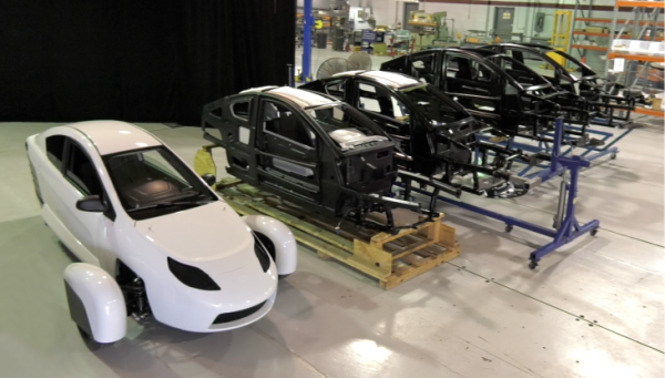

EKH touched on this earlier and I found it interesting.
In the first paragraph, it says " The Elio space frame / body panel design architecture has been morphed into a traditional unibody design in the latest iteration.." This makes it sound like metal spaceframe and metal body panels.
I do not think the second paragraph is well written. I get the impression the spaceframe has become stamped metal and not welded tubes. I get the impression the body panels are not necessarily metal.
The picture at the top is of the E1 spaceframe which is stamped metal. I thought traditional unibody designs welded structural parts and body panel parts together into one piece. Here, the spaceframe (made of stamped steel) is separate and distinct. I get the impression the original design of metal spaceframe and composite body panels is still planned, but now the spaceframe is stamped, not welded tubes.

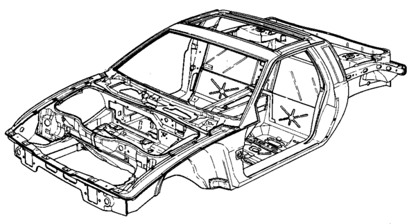

The paragraph is a bit convoluted. I suspect that the same document was edited, but the editor also mixed up the terms in a few sentences. Essentially, the Elio is a frame-with-panel design that utilizes a stamped unibody frame. Think of it this way: cars are built with both a body and a frame. The "frame" holds all the important bits, and the "body" is the aesthetic bit.
  • Modern pickup trucks are a solid frame with a stamped body placed on top.
  • Modern cars are full unibody construction, where the frame and the body are all a single unit.

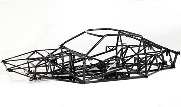

  • Race cars are space frames with panels bolted on to form the body. (space frame = welded tube frame)
  • The Elio is a stamped unibody frame with panels bolted on to form the body.

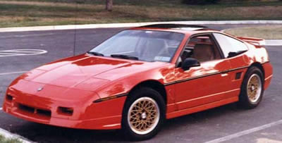

EM is explaining to the SEC that this latest design change is different, but not completely unheard-of in auto manufacturing. Here is a picture of the frame to a Pontiac Fiero, which also used a stamped unibody frame-with-panel construction. Aside from the front fenders, you can see the similarities to the Elio, yes?
Now, contrast this with a "Space frame", which as I said is a welded tube design.
