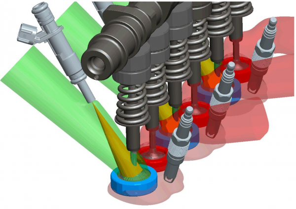

A self-adjusting hydraulic valve lifter for an overhead cam engine wherein this pressure fed hydraulic valve lifter is interposed directly between a valve and cam, the lifter including an upright, cup-shaped plunger engaging on the valve stem and being reciprocally received in a larger, inverted, cup-shaped follower which engages the cam and which is slidably guided in a fixed bore surrounding the valve stem, a pressure chamber being formed between an end of the plunger and the follower, with a helical compression spring positioned therein to normally bias the plunger and follower against the valve stem and the cam, respectively, and a fluid supply passage is provided to supply fluid under pressure to the pressure chamber, the fluid supply passage including a V-shaped groove with an O-ring seated therein to serve as a one-way check valve controlling the flow of fluid to the pressure chamber.
Looking at the cutaway of the valve train you can clearly see the oil groove in the hydraulic lifters.
Thank you for the hydraulic lifters! Hoorah ! I am proud of the though and the conclusion to use hydraulic lifters!! Maxium and consistent efficenty at all times!

The hydraulic valve lifters are no surprise. The engine seems to be an upgraded version of the Suzuki G10 993cc engine, as fitted to the prototypes and that already has them. Using any other method would certainly be a retrograde move and would also increase servicing costs. The last car I drove with bucket and shim valve lifters was in 1973, a 1967 Singer Chamois,with a Coventry Climax derived engine.
As an aside, the new IEV engine seems to retain the Suzuki gearbox bolt fitting pattern....I can only speculate on what transmission they will use on the production models.

I was wondering that very thing. Is it possible they'll use some kind of hydraulic lifter which effectively makes the valves self-adjusting? I haven't had a vehicle that required valve adjustment since my 1980 Mazda and I didn't think anyone still did that. (I know they do on motorcycles but am not sure why)
Actually it is still fairly common. I have a 2002 Honda Odyssey and a 2006 Accord and both requier the valve clearances to be adjusted. At least they do have set screws in the rockers.
I have read tech talk v24 and nowhere is there any mention of the valve train at all

The point is very simple. Having someone cobble a description of the operation of hydraulic cam followers and present it under the letterhead of an Elio tech talk is confusing to say the least. Like everyone else here I am trying to gather information from this and other forums.I have read in several different places that classed shims are used. I've also read that hydraulic cam followers are used (which makes more sense even though more expensive). Just trying to get answers.
