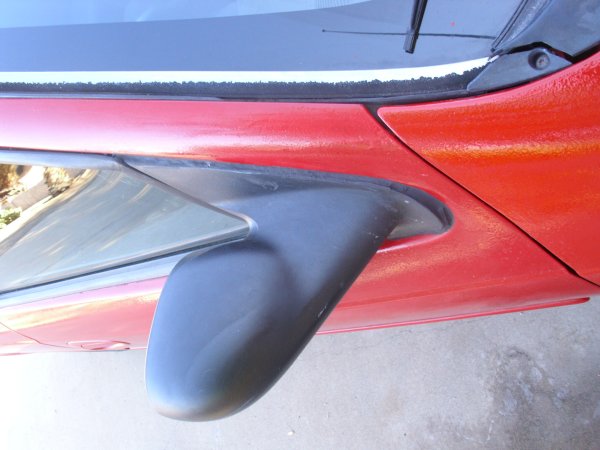

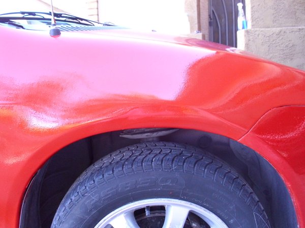

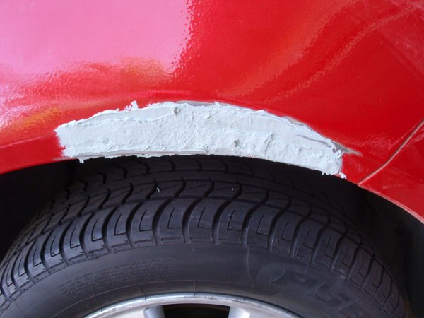

First two coats of Bondo applied, after sanding I think I'll need just one more thin coat, then it will be ready for primer.
Upon further review, I might just run a bead of black caulk around the mirror housing to hide the glue line. And yes the construction adhesive has the mirror more than secure, that thing ain't coming off!!
You might want to finish it off with some red vinyl decal stuff. Just go to a sign shop and see if they have something in the scrap pile that will work which matches close. They produce so much scrap that you'd be amazed what you find and can do with that stuff. A hair dryer and some times to put it on, it'll last long enough and look good from 10ft away.

My girlfriend's car is all done. We just need to park it in the sun and let the new paint "fade-in". The mirror looked better with black caulk vs. painting the glue line with black paint.
It's not perfect, but the car is presentable.

Thank you... I live in Arizona.
Working on cars is just a hobby, I'm really not that good at it. I think this could be referred to as a 5-10 foot repair, any closer and you'll see the imperfections.
My girlfriend is really upset about the accident. There wasn't much I could do to make her feel better, other than try to make the car look better.

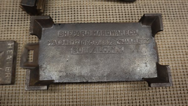

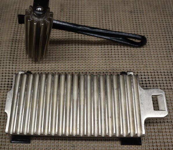

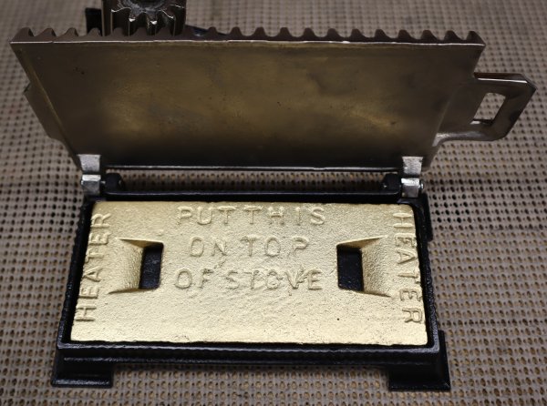

Something different. In the 1800's to smooth a shirt or pants you used a cast iron iron called a Sad Iron. You would heat it up on a stove or fireplace. A special one for ruffled cuffs and collars was called a fluting iron. Here is one patented in 1880 that I restored. The fluting plate and roller were nickel plated. The black is a high temperature paint. Could not resist painting the metal slug inside gold. Giving to a friend.
