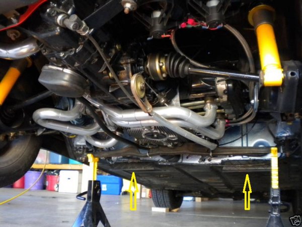

Not sure if this is what you had in mind, but the Porsche 914's have flaps (vortex generators?) just forward of the cylinders to create a low pressure area there. Helps with the airflow through the engine tin when you're up to speed. Kind of hard to see in the pic, got the yellow arrows pointing at them. I could see like a half conical shape on it's side, narrow end forward (rubber) just forward of the rear tire might do something similar. Just thinking...

Ultimately a belly pan should completely flat and sealed with only enough air allowed to circulate to flush out any exhaust gases. A boat shaped rubber splitter forward of the rear tire flexible enough to deflect upon impact with road debris. Not sure how low it would need to be to be effective. Seem to recall seeing 1.5 inch somewhere. Maybe something similar in the leading edges of the spats.
Yes this is exactly what I am thinking about. It will be fun to play with this kind of thing when we finally get a chance!

I like your idea of a rubberized piece. I have been picturing something (shaped) like a shark fin antenna, turned upside-down, with the back of the fin "open" with the tire kind of "tucked in."
Sounds good, shark fin or boat bow shaped like skygazer mentioned, but I think we'd need to leave enough room between the air deflector [for lack of a better term] and the tire, so that if...more like 'when' you hit some road debris, it won't cause contact between the deflector and the tire, might end up making some of your own road debris :eek:. Maybe the deflector would be better mounted to the rear wheel swing-arm so it would travel with the wheel, and not the floor pan...Man! Can't wait to see what the bottom of the Elio (production model) looks like.
