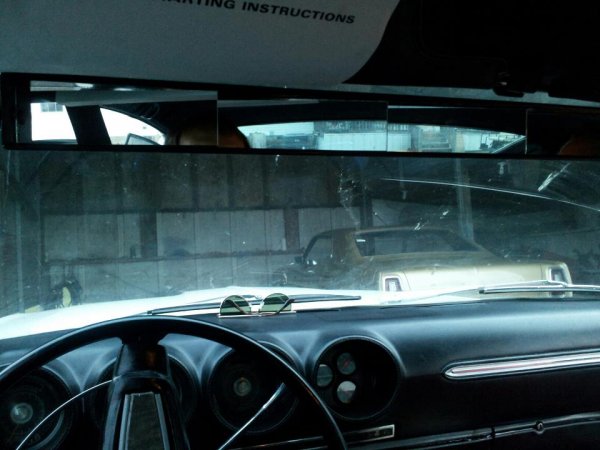

Remember the old "Wink" mirrors? They were a series of small mirrors that went completely across the top of the car (in place of the visors), and I had one of these on my tow truck, couldnt beat it for visibility. I have tried to find them lately but they seem to have disappeared.
