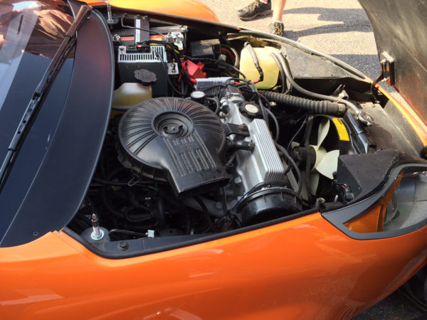

ElioJoe
The P4 at least uses a standard automotive battery located at the top left of the engine compartment.
Here it's seen next to a small power inverter used to keep the lights running all day at indoor events, which will not be in the production version.
Remember that the P4 does NOT have the production engine. While it IS cool to see under the hood, the final setup will undoubtedly look completely different. :)
