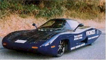

Definitely not a new idea. A lot of the issues up to now were the bulk of Sterling Engines in times past. And they do get less efficient as they get smaller.
Interestingly, one of the research Viking cars at Western Washington University link, replaced the sterling with IR solar cells to create the Viking ? 23 ?.
The benefit here was size and flexibility in the package shape. Absolutely any fuel was possible for the technology, even straw, depending on the repackaging. These cells came from woodstove heat recovery systems by YZsystems, or YX or something. (Retailer Link).
These things are less efficient than a Sterling for mechanical conversion, but cheaper and lighter per watt (at the time), and therefore travel better.
I don't know how this balances out per any recent advances. See Seebeck devices
