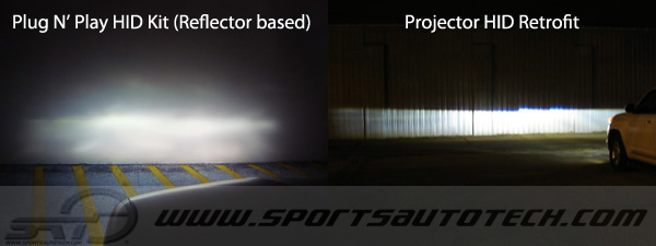

@JEBar Ah yeah, I think you're right, the headlight really would bounce around a lot, and if using incandescent bulbs, you might end up going through a bunch of them. I personally will buy the HID upgrade to use with the Projectors (You do NOT want to do an HID upgrade if there are no projector housings*).
*Off Topic: On a side note about HID headlight upgrades. Most of the annoying, blinding headlights you see on the highway that are ridiculously bright, are people that have gotten the super bright HID bulbs, but not purchased the proper housings for them. The reflective cups on factory Headlight housings can be overwhelmed by too much light, causing the light waves to bounce around and scatter improperly. Below is an example of bad on the left and good on the right.

@JEBar The reflective cups on factory Headlight housings can be overwhelmed by too much light, causing the light waves to bounce around and scatter improperly. Below is an example of bad on the left and good on the right.
While this is a real problem, this explanation is 100% bogus. It doesn't matter how much light there is, it all reflects the same. The problem is that reflectors are shaped for specific bulbs emitting light from specific areas, and if another bulb emits light from a different area then the reflectors don't focus it as the manufacturer intended.

Also, HID "upgrades" have recently been deemed illegal over here. Too many people were fitting cheap and nasty aftermarket kits which can cause terrible dazzle to oncoming traffic. In UK we have to put our vehicles through an annual safety check known as the MOT test. If the vehicle fails, it can't be driven until the defects are rectified and the insurance will also be deemed invalid. If you get caught driving without insurance they will impound your car. HID headlights mean an instant MOT test fail and there's no let out by trying to go elsewhere in an attempt to pass - everything is now on a computer database and once the fault is on there, there is no hiding it. If you drive without the test certificate, there are now number plate recognition cameras linked to the database computer, they are at service stations, fitted to police cars, everywhere.
