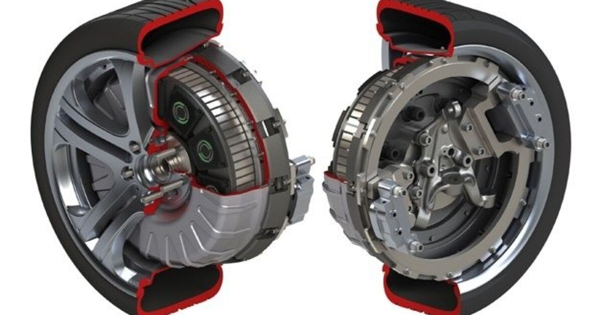

I you look at the bottom of the Elio Motors website they say all the pictures are of the gas powered prototype. To the best of my knowledge they do not have anything done physically yet on the EV version. They said they had Roush look at it and they determined a good bit of the engineering for the Elio could be re-used. Obviously the drive train is the biggest change. I hope they consider an in-the-wheel type motor and leave the current engine space for an additional range battery option. 150 miles won't cut it.

The only tuff things about adapting any car to EV,
1) Manual transmissions are a much easier conversion than automatics. (often only 1 or two gears required)
Elio has that option. Just need the adaptors, which are not hard to provide. Single gear, stepped belt solutions are easy too.
2) Power steering - there are already common electric-motor solutions
3) AC - again, there are already common electric-motor solutions
4) Where to put the batteries, and accommodate the weight, not hard in a short-range demo for show only.
4a) A lot harder for longer range and reliable in crashes or for other handling dynamics in the production vehicle.
The current exhaust path could be placed on both sides and would provide extra spaces for more batteries.
I think the most important question is, does a $15000 USD vehicle expose enough profit margin to excite a 'real' investment?
... given that Tesla and others could step in and compete in just a few years?
Hub motors are much more problematic, in a trike, affecting many dynamic issues. Very attractive, but not that easy. Custom engineering for each application is required in my opinion. But I would like to see one someday. Maybe combined with those airless tires that might not need that much suspension.

1/ well they don't have a production vehicle, so just an EV forward and reverse transmission will do
2/ and 3/ Yes
4/ Low and forward if possible. Mount them weakly so they break off in a side accident, absorbing some of the impact kinetic energy.
Lotus did some extensive testing with hub motor wheels, and found with the use of good quality dampers, the much mentioned unsprung weight wasn't a big issue.

I'm really waiting for the motors from Linear labs to become available. Last I heard they were still building a plant in Texas. Still a private company too.
