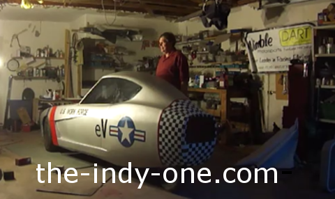

Will there be an Electric Elio?
There is already another 3-wheeled EV that is going to be made.
the-indy-one.com
