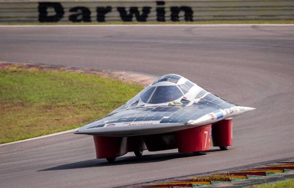

A Dutch University Has Just Won Australia’s Solar Car Race
Oct. 22, 2015
Morne de Klerk—Getty ImagesThe Nuon Solar Team of the Netherlands celebrates after winning the 2015 Bridgestone World Solar Challenge at Victoria Square on Oct. 22, 2015 in Adelaide, Australia

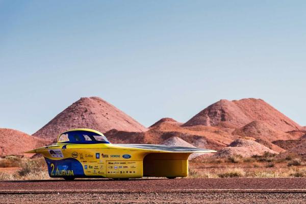

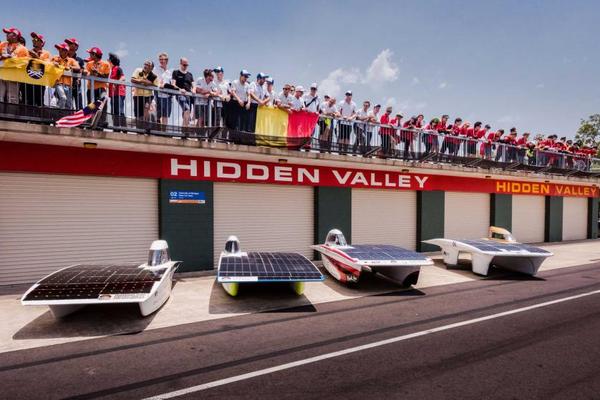

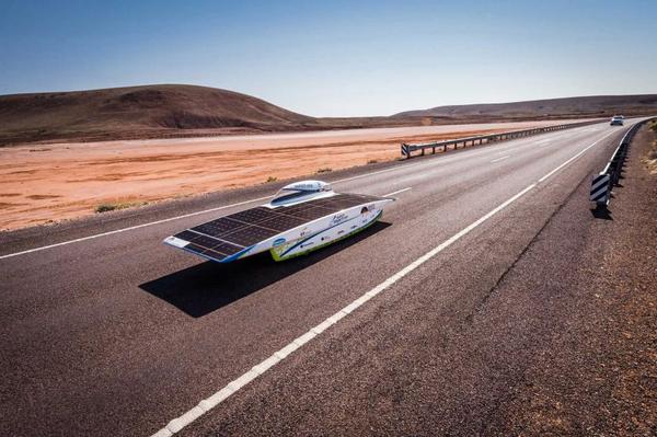

The biennial race is a friendly testing ground for cars that run on nothing but the sun
THESE AMAZING SOLAR-POWERED CARS JUST RACED ACROSS AN ENTIRE COUNTRY
Geert Vanden Wijngaert—AFP/Getty Images
The Belgian Punch Powertrain Solar Team near Glendambo as the team races on Day 4 of the 2015 World Solar Challenge on Oct. 21, 2015. 45 Solar cars from 25 different countries participated in the 3,000...
competitors in the nation’s solar car race, of which the team from Delft University in the Netherlands won its second victory in a row on Thursday.
Held once every two years, the World Solar Challenge is a friendly testing ground for cars that run on nothing but the sun. The hope is that one day the technology will find its way into consumer products, the BBC reports.
This year more than 40 teams from universities and schools around the world set off from State Square in Darwin on Oct. 18. Five days later, after 37 hours, 56 minutes and 12 seconds of driving, Delft’s Nuon Solar Team’s car Nuna8 was the first to cross the finish line at Victoria Square in Adelaide.
It was a tight race. Nuon’s countrymen from Solar Team Twente and its car Red One joined the revelry just eight minutes later. Japan’s Tokai University took third.
How do you celebrate after five days in the scorching Australian Outback? The orange-clad students jumped in the square’s fountain, naturally.
