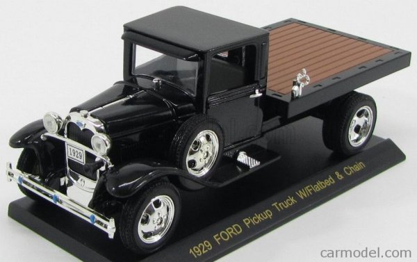

I always wanted to build an early model Ford Flatbed truck. Something in the 1929 to 1932 range. With an electric motor driving the front wheels, a dropped axel (like on a trailer) could be used in back, keeping the bed lower. Figure there would be lots of room for batteries under the bed and that the batteries would keep the weight somewhat centered. Picture below is a model of a flatbed.
Brookville Roadsters is just a few minutes away from where I live, and they have complete new bodies, including extended.
https://brookvilleroadster.com/
Now all I need is to hit the lottery, retire, and build it.
You could almost keep the rear the same as Tesla modules for the Model 3 are about 3.5" thick. I'd think that the total you could build for a bed would be around 5" thick. Then put 1/2" thick planks on top and the sides. It'll disguise it as a flat bed. For the front if you use upper and lower control arms and uprights from a Subaru (like what Factory Five does on the 818) then you would have hubs with splines where you can put axles in it. Then run that to the transverse EV powertrain. You could also use strut assemblies from a late model Camaro as the front hubs are from something else and thus have splines in them.
